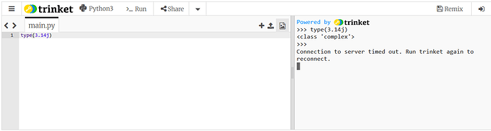

Just a short question, in this code snippet
obrĂĄzok
Which part of the number here is the real part and which one is the imaginary? I am not quite sure what the j at the end defines.
In Python, complex numbers are represented in the form a + bj, where a is the real part and b is the imaginary part. The j suffix explicitly denotes the imaginary unit.
