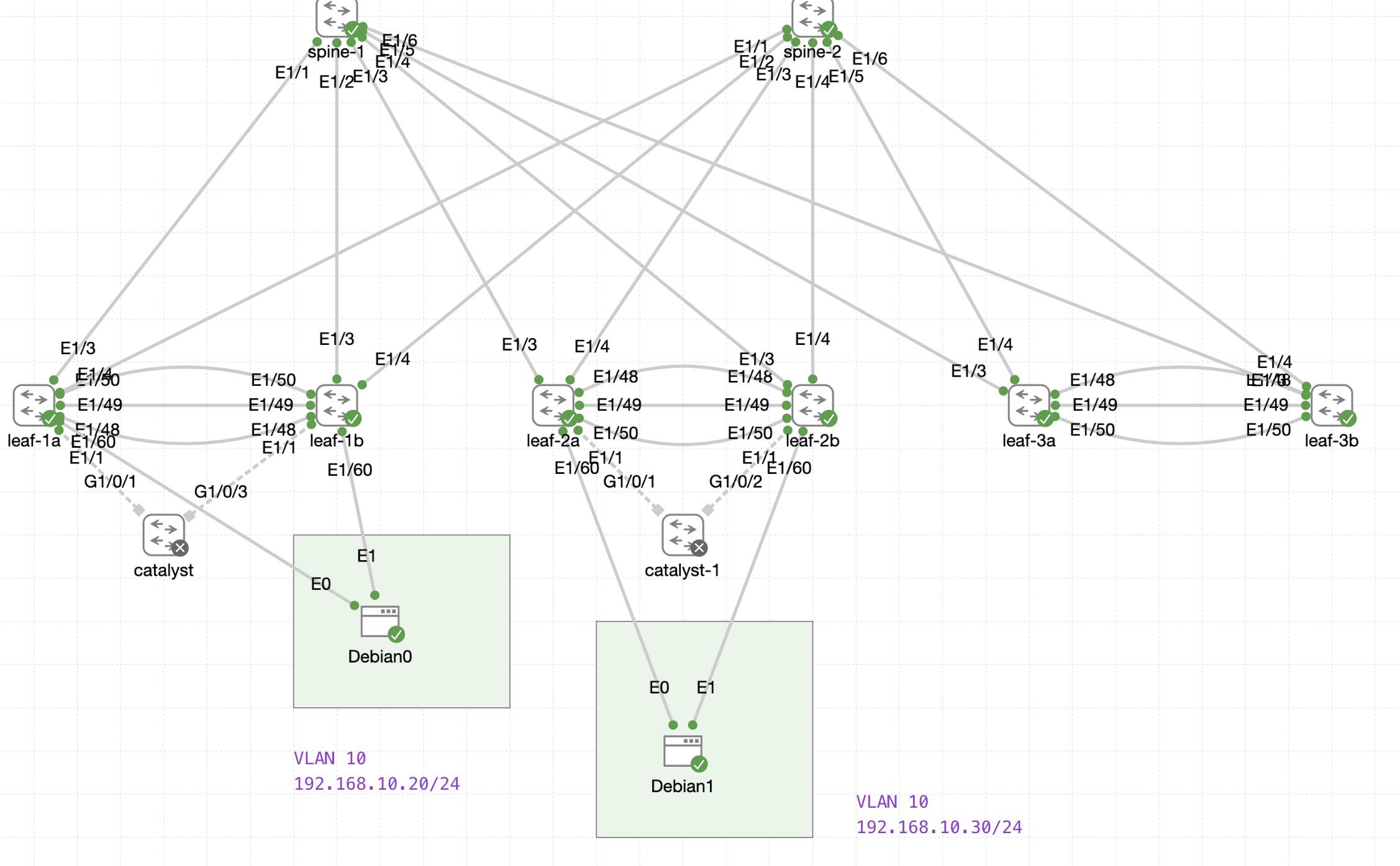

I have a layout with 2 spines and 6 leaf (2 couple in vpc); How many AS numbers should I create?
One per single element, or for 3 leaf vpc, one per vpc couple ?

Yes, makes sense, currently I have this situation in my lab, each single switch is an AS. Maybe with spine in the same AS I can remove spine bestpath as-path multipath-relax
Screenshot 2026-07-05 at 09.01.22
If a single pair are in the same AS, must I use allowas-in ??
