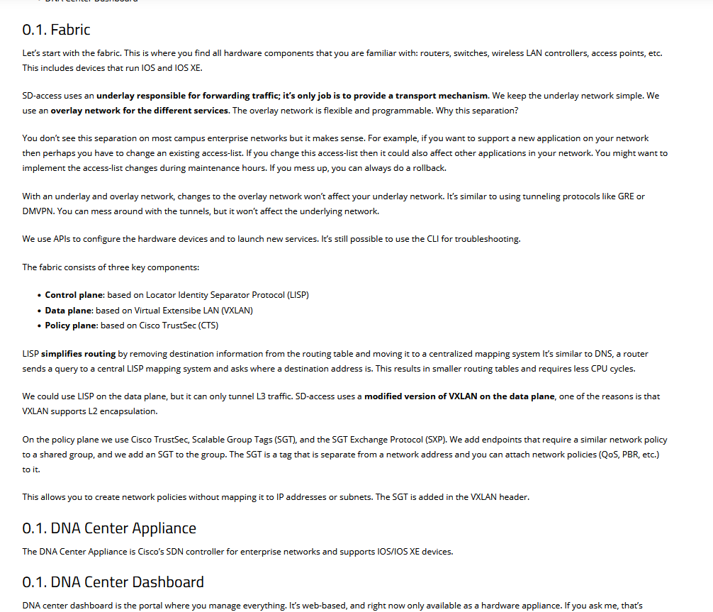

The numbering on this lesson is a little out of place, for ex:
Kind regards,
Thanks @davidilles it has been fixed.
