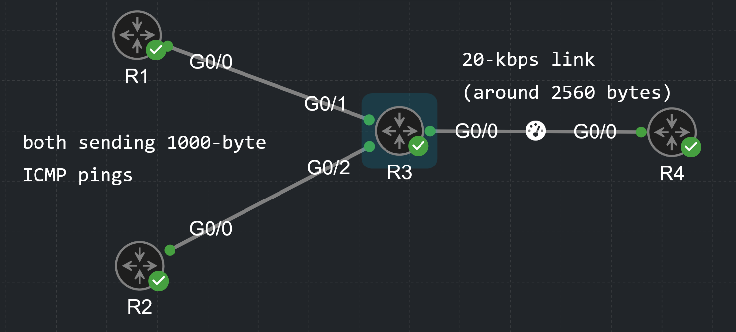

Is QoS possible to test in CML? Here’s my topology:
obrázok
On R1, if I generate a ping, the first 3 pings are sent within a few ms and then they slow down. This is because, I suppose, due to how fast they’re being sent at first, they will up R3’s G0/0 queue.
If I start pings from both routers, the overall ping performance will slow down as they’re now both competing for bandwidth.

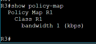

Here’s where the trouble starts: I’ve purposely configured a policy map for R1 to have only 1 kbps of bandwidth available (this is like 125 bytes)

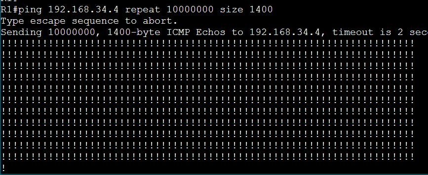

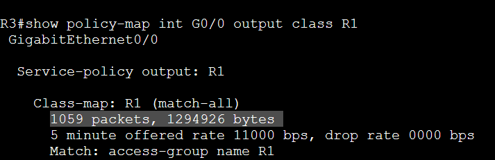

Packets are being classified, yet R1 is still happily sending 1000, even 1400-byte pings. Not a single packet there is dropped despite it having only 1 kbps available.
obrázok
I could say that “yeah, the default class is probably providing BW to this class” but that can’t be possible because R2 is cosntantly sending large pings.

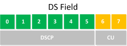

How did you get the following decimals?
  • DSCP EF (46) is 101110 in binary, that’s 184 in decimal.
  • DSCP CS3 (24) is 011000 in binary, that’s 96 in decimal.
Hello Marcus
The decimals 184 and 96 are derived from the full 8-bit Type of Service (ToS) / Differentiated Services (DS) field in the IP header, not from the 6-bit DSCP value alone. This here is the DS Field:
So although DSCP EF (46) is 101110 just from the DSCP field, you have to add the last two bits as zeros which are the CU section (now referred to as ECN) of the full 8-bit DS field, which makes it:
10111000 = 184 in decimal
Similarly, DSCP CS3 (24) is 011000 in binary, adding the last two zeros we get 01100000 = 96 in decimal.
